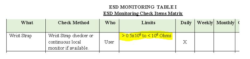

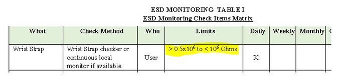

Hi John,
Below wrist strap test limit control appear in one of our customer(semiconductor) spec.
Have you came across this type of stringent wrist strap control? If yes, how to achieve this?
I asked my customer if I can control according to ANSI standard < 35M ohms, the reply is “please follow this spec, as this is standard for all our subcontractor. Still within ANSI spec, but tighter.”
Current ESD wrist strap we use are embedded with 1M ohm. WRIST STRAP SYSTEM TEST reading I can get is more than 1M ohms. (2.0M - 3.8M ohms)
Thanks,
KK
