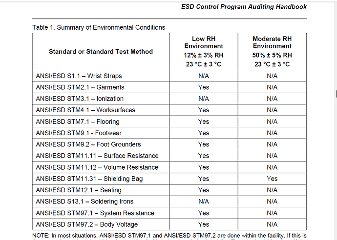

As per ESD Control Program Auditing Handbook, need to qualify worksurface, Surface resistance, Volume resistance, system resistance and body resistance under the 12% ±3% RH.
So need to understand how we can comply this requirement for mentioned items as these are the measurement methods.
