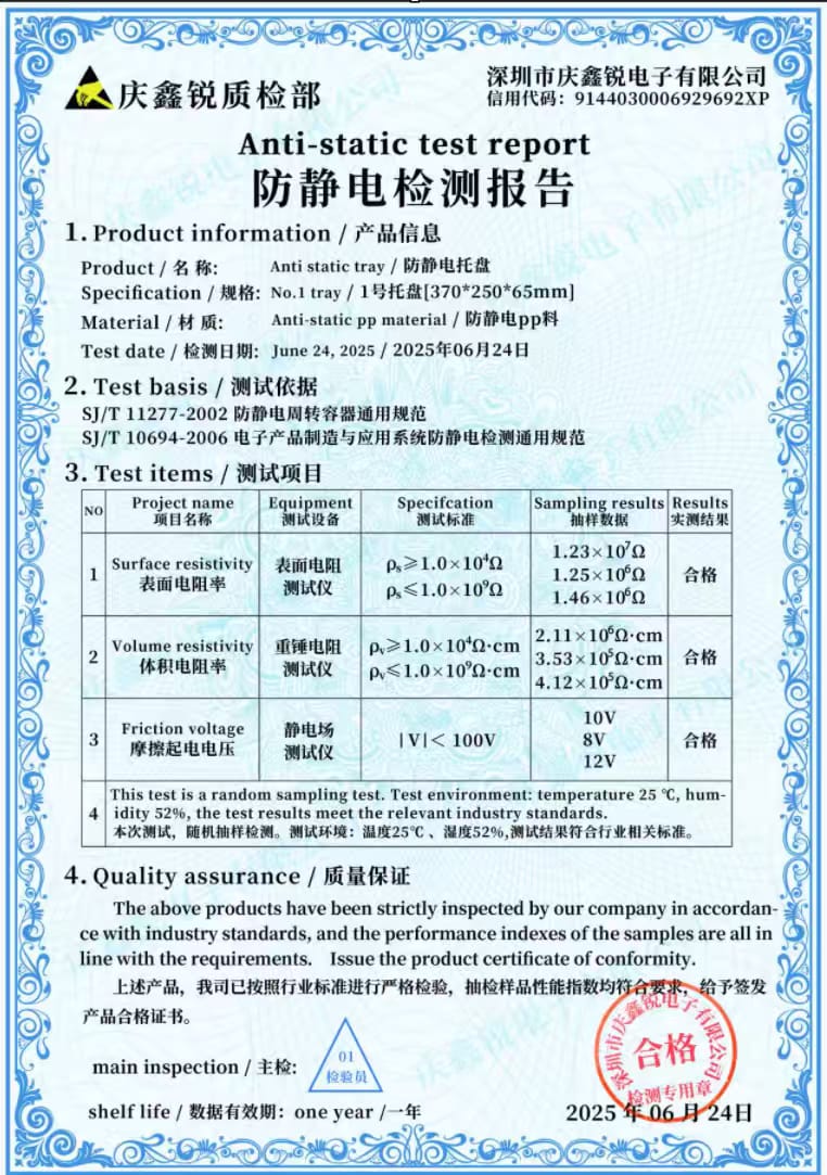

Supplier from China provided the Product Qualification report but not according to ANSI standard. Can this be accepted ?
Ching,
I don’t believe this certificate would meet the requirements product qualification requirements for packaging of ANSI/ESD S20.20 for the following reasons:
  • The test basis/methods used are SJ/T 11277 and 10694 which are Chinese standards. The packaging section of ANSI/ESD S20.20 requires that the resistance measurements meet ANSI/ESD STM11.11, STM 11.12, or STM11.13. Unless the Chinese standards can be proven to be technically equivalent to the ANSI/ESD standards, this would not be acceptable for ANSI/ESD S20.20 certification
  • The ANSI/ESD standards require the test environment to be at 12% +/- 3% RH. These tests were done at 52% RH. Unless your facility can show that its lowest annual RH is higher than 52%, this test report wouldn’t be acceptable.
  • The first two things measured on the list are surface and volume resistivity. Resistivity is usually measured in ohms per square and is 10 times lower than resistance. The results of the report show a resistance measurement. Maybe the English word “resistivity” was translated wrong but this calls into question the test method used
Note: The friction voltage test in this test report may be acceptable for the low charging property from ANSI/ESD S541 as the limits and test method are user defined. So if all you are using this report for is its low charging (friction voltage) part, it may be acceptable

  1. If you have implemented an ESD control plan per ANSI ESD S 20 20 2021 then this PQ report shall not be accepted .
  2. If your ESD control plan is neither per ANSI S 20 20 -2021 nor IEC 61340-5-1-2024 and if you are following your own documented plan then perhaps you may or may not accept it
