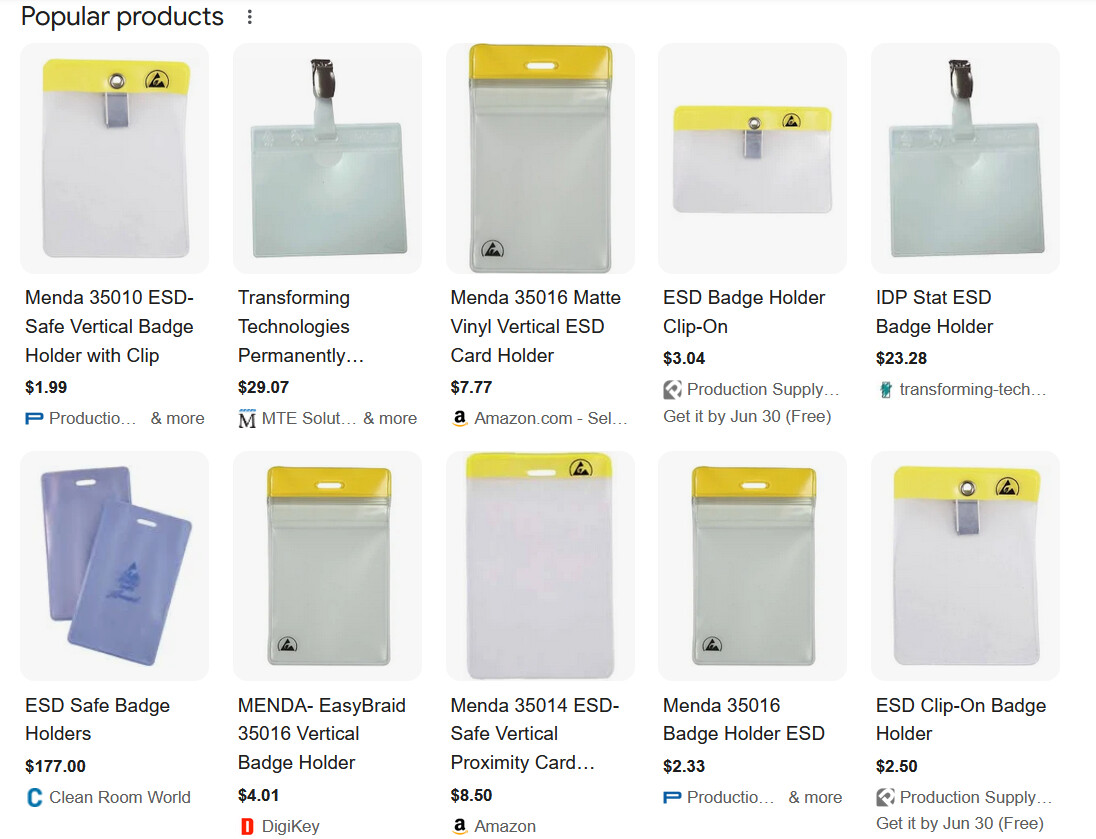

I did a quick Google search and found there are many ESD safe badge holders on the market if you need one (see picture below). I think your best solution is what you are trying to do and that is keep the badges inside the ESD garment. If you are doing a compliance verification measurement for the badges, remember you should do this in the actual working conditions, with the badge worn against a person without artificially tribocharging the badge. Likely any badge will not exceed 100 volts as the person’s body will supress most of the voltage
You could apply a staticide to the badge holders which would reduce any tribocharging although it would likely need to be reapplied every few months.

Thanks a lot Andy!!
We have received the same samples which you google but our management team is asking for better solution with standard ID holder sample.
