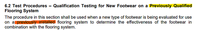

6.2 Test Procedures – Qualification Testing for New Footwear on a Previously Qualified
Flooring System

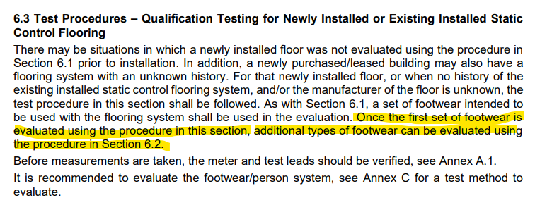

6.3 Test Procedures – Qualification Testing for Newly Installed or Existing Installed Static
Control Flooring
So, we have a case where we have a location (old location) with an existing “ESD” flooring. So for this case 6.1 doesn’t apply since this one has to be executed prior to the flooring system installation.
Our options are 6.2 and 6.3. For 6.2 we have to qualify new footwear on a “…previously qualified flooring system” which we don’t have yet. and for 6.3 we have that “…a set of footwear intended to
be used with the flooring system shall be used in the evaluation. Once the first set of footwear is
evaluated using the procedure in this section, additional types of footwear can be evaluated using
the procedure in Section 6.2”

Note: To me in 6.2 is weird that in the title it calls out for the word “qualified” when in the explanation it doesn’t call out that word “qualified” but “installed”.

I agree the word “installed” in the text of section 6.2 should probably be “installed and qualified”.

Section 6.3 requires “a set of footwear intended to be used with the flooring system” So the footwear would not be qualified at this point, only intended to be qualified using section 6.2.

I think that is a safe bet although the sentence you highlighted seems to indicate the footwear used to qualify the floor is also qualified although the 3 samples of footwear is not required as in section 6.1 and 6.3. I asked the WG97 chair about this and will get back to you with his response.

This section is for newly installed flooring (which has already been qualified using STM7.1, Section 6.1 of this STM and STM97.2 and using footwear that has already been qualified using STM9.1, Sections 6.1 and 6.2. of this STM and STM97.2) or existing installed static control flooring which is already installed in a newly purchased / leased building that has an unknown history.
As stated in the 1st paragraph, 4th sentence in this section: “As with Section 6.1, a set of footwear intended to be used with the flooring system shall be used in the evaluation. Once the first set of footwear is evaluated using the procedure in this section, additional types of footwear can be evaluated using the procedure in Section 6.2.”
It is stating a “set” of footwear not one sample (pair). Looking at Section 6.1.1, it states, “… a minimum of pairs to be tested shall be three (3) pairs, labeled from 1 to 3.” Therefore, the requirement in Section 6.3 is a minimum of 3 pairs of footwear to be used for the procedure outlined in this section using the flooring sample points outlined in Section 6.3.1.
The 4th sentence also states “… additional types of footwear can be evaluated using the procedure in Section 6.2.” Therefore, instead of testing the additional footwear at all the test points outlined in Section 6.3.1 that testing can be performed at only one location as outlined in Section 6.2. for these additional types of footwear.
Regarding the second question (which was: "the opening paragraph of section 6.2 says “The procedure in this section shall be used when a new type of footwear is being evaluated for use on a previously installed flooring system…”. Shouldn’t it say “previously installed and qualified flooring system”? “
The title of this Section 6.2 does state Previously Qualified Flooring systems. Therefore, it is not required to restate."
